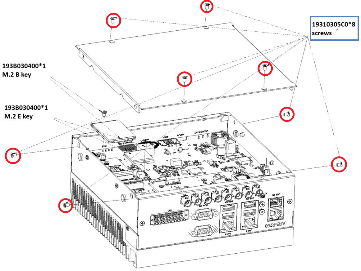

Step 2: Open Bottom Cover​
Open the bottom cover of AFE-R750 to access recovery pins.
Bottom Cover
